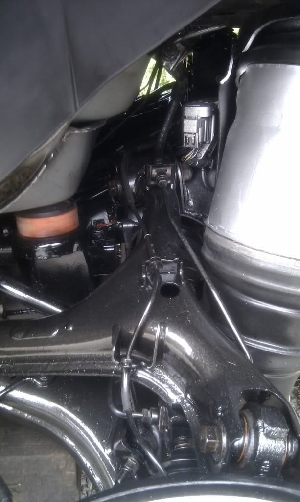

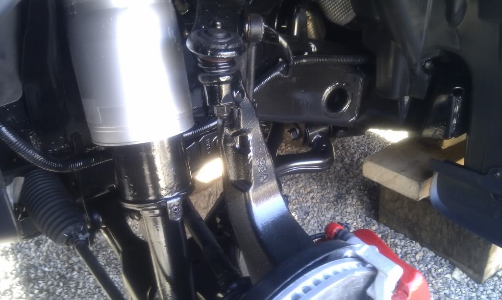

I'm useless at DIY stuff, but I did my calipers, hubs & chassis just with a couple of cans of VHT & hammerite, still looks great ... IMO Thumbs Up

OcJo.....did u paint yor discs aswel??! It looks like u have?

No,he's just painted the hub.Maybe a little overspray on the disk but that wont last long.He's done a cracking job though Thumbs Up

As Mrfixit said i painted the hubs too ... I got quite alot of overspray on the discs Whistle but within 2/3 miles they were fine.
