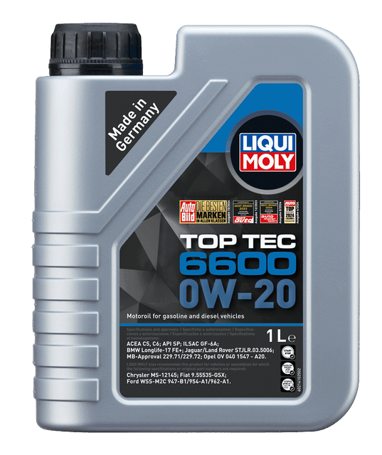

I'd go with 0w20, the quicker the oil circulates through a cold engine, the better!
I'm using LiquiMoly TopTec 6600 in mine
