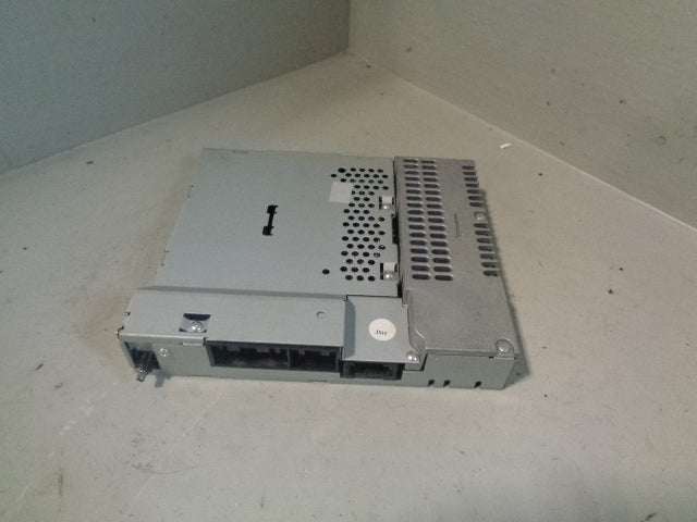

Hi All,
I "think" my amp might be finally dead. Its the non logic 7 Hardmon Kardon amp with subwoofer in the tailgate.
Symptoms are the following -
no audio - volume control makes no difference but does increase in number on the screen.
all fuses are ok
radio stations don't show their names either
I disconnected the battery for a few hours, and made no difference
I checked the fibre connection - and I can see red light on the cable, but no return red light coming from the amp itself.
When I disconnect the amp - the volume doesn't increment in number up/down, but starts working again once connected back.
I haven't checked voltage but thats my next port of call.
From reading the forum - I see the bluetooth module is mentioned a few times - is that further down the chain of connections and should I investigate that further ? or just pull the trigger on a 2nd hand amp from ebay.

so bumping my own thread here with more information.
I bought a amp off ebay - same type. 08 though vs my 07.
Anyway I've just wired it all in, and on initial power on - I could see red light coming from it. However once all connected up - same problem. No audio.
Can anyone advise what is the previous MOST/Fibre device in the chain, i.e. the one before the Amp, as that might be my problem.

doing a bit more research - I noticed an L322 has the tuner part seperate.
and flip that image upside down - it looks the same as what is attached to the L320 headunit
Anyone ever take one apart and see if these parts are interchangeable ?

so I've found the problem - multiple capacitors and ICs gone leaky leaky. I'm surprised its even able to play a CD !
I've also confirmed my suspicion that the radio part of the unit - is phyiscally the same as the L322 unit, unable to confirm if the innards are the same though. I am tempted to take a gamble on one and see can I connect it up.
I've so far been unable to find a clear picture of the board used in VUX500104 (L322 radio).
Did find this thread on a RU site - and I can see part of the board, and all matches except for a socketed part. Alas no sign of the ribbon connectors.
https://www.drive2.ru/l/560235810041889867/
