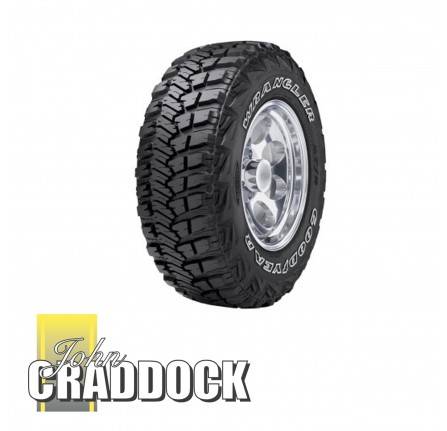

There is a new shape MTR, Craddocks do them ISTR.
PS Here ya go http://www.johncraddockltd.co.uk/products/...r_111s.php
