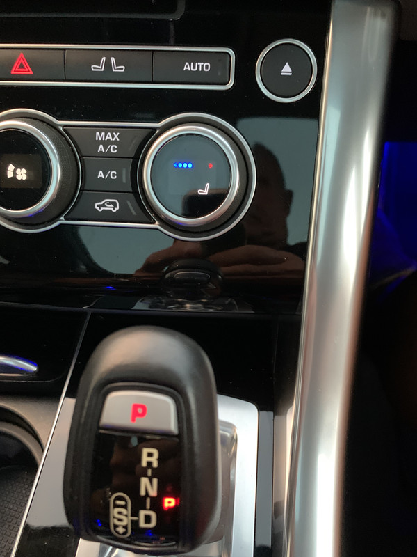

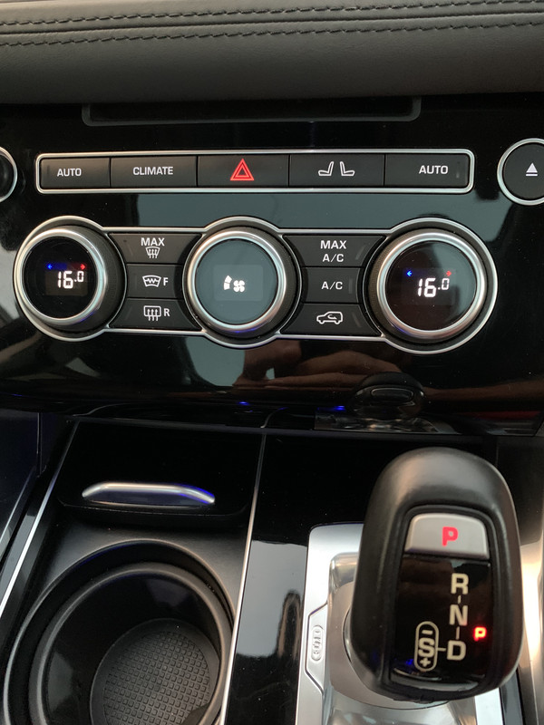

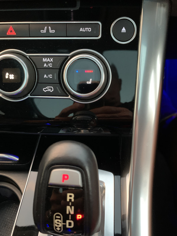

I changed my a/c panel to the later 2016 panel on Thursday, from start to finish around 30 minutes, and a much needed upgrade, it also looks more modern, £65 from eBay

Sorry for the late reply guys, I managed to find a really good second hand one in extremely good condition for £65
Install was easy as long as panel is 2016 it'll work and makes a huge difference, it basically means the cooling or heating seats can be turned on immediately you don't have to wait for the screen menu to boot up.....also when you switch car off for 10 minutes ie at petrol Station or shop it remembers and goes to last setting
