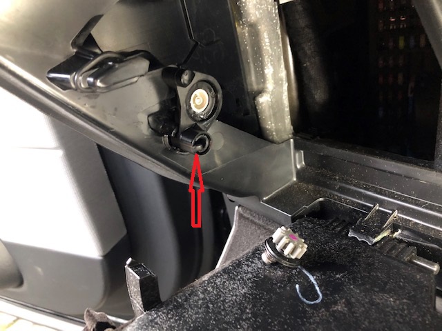

Eventually got this sorted. The correct part number for a right hand drive vehicle is FFZ500080.
When I dropped the glovebox, I was presented with this:
The cog was loose and with the lightest touch, it fell off:

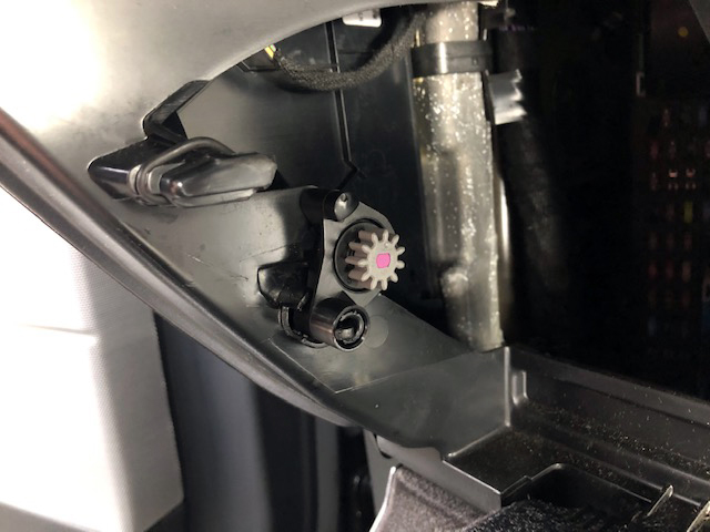

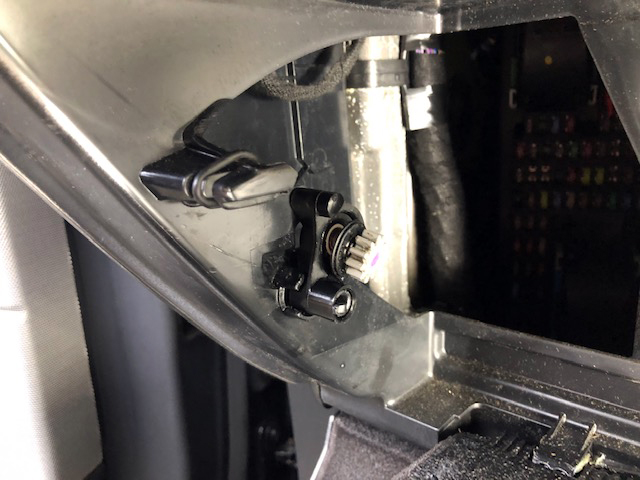

Gently push this tab towards the front of the car and pull the assembly off:
Then install the new part, close the globe box and job done. Soft opening glovebox:
