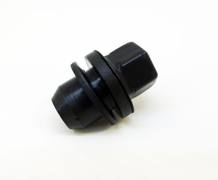

Hi everyone,
After a fraught experience changing my Defender's tyre in a field and stripping one wheel nut, I am considering getting a set of these/similar for the RRS so that the caps don't become a problem.
https://www.ebay.com/itm/25-GORILLA-RANGE-...1303887393
Anyone done this and can recommend/not?
Thanks --

Read the description they are not capped,,all 3 sets I’ve had are not capped. Thumbs Up
If these don’t fit yours they have them for different models.
20 BLACK FINISHED GENUINE Land Rover NUTS.
22mm HEX head size
22.5mm Shank Size
14x1.5 Thread (M14x1.5)
Full Solid Wheel nut (no cap to loosen)
Quality Black Finish
Fitment
Land Rover Discovery 3 - 4 - 5 - Sport
Range Rover Sport (2005-2013)
Range Rover L322 (2005-2012)
WILL NOT FIT OLDER THAN 2005 LM322 Series wheels.
PLEASE NOTE - you must match the correct nut with the wheel you intend to fit. The thread type is the same on the Sport, LM Series and Discovery.
What's Included
20 BLACK FINISHED GENUINE Land Rover NUTS. Andy.

But the picture shows capped nuts? And if they are Genuine LR nuts, as the descriptions says, then they are capped?
from the horse's mouth:
"Neil Rumney neil@sixonetwo.co.uk via sixonetwo.onmicrosoft.com
09:21 (1 minute ago)
to me, Web
Hi, these nuts have press fitted steel caps. Our supplier also makes them for Range Rover themselves." --

Weird,, all the sets ive had from them haven't had the caps on them.It aso says in the description they are not capped.
Full Solid Wheel nut (no cap to loosen) that what it says.
Even the ones ive seen fitted in LR dealerships the black nuts have never had the caps on them only the silver ones,,the my15 I have now came with the stealth pack fitted & solid black nuts from dealer when new. Andy.

finally found a supplier: https://www.ebay.co.uk/itm/303147219363?ul_noapp=true
Quote:
New message from: thealloyhubltd (4,074Red Star)
Hello there,
Thanks for your enquiry,
These are one piece nuts that have been powder coated black. The capped wheel nuts tend to simply fall off.
Post #591031 Tue Nov 26 2019 12:44pm
Posts: 1199
and another in the US: https://www.amazon.com/gp/product/B01N14W0VF/ref=ask_ql_qh_dp_hza
now to decide which look better quality-wise and price-wise. Rolling Eyes --
