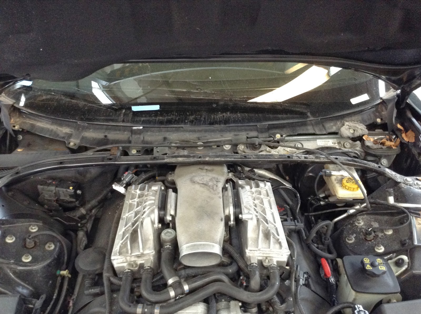

Do I have a pipe missing here?

No i looked at that with mine its designed like it Thumbs Up

ok but it looks like there was a pipe there as its shinny on the end.. 2006 RR Sport Supercharged Love this car

no i checked with hbh who are near me Thumbs Up

On jags that is where the charge cooler water is filled.
On a Jag.
Top up/bleed
