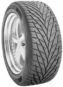

I only saw this tyre on 22" rims here in the US, Overfinch USA uses them quite a bit when they upgrade stock Sports wheels with their Tiger or Supersport rims. I actually know a few owners that have them and are very happy with them, but only on 22" wheels. |
tf9 Member Since: 07 Jun 2006 Location: Moscow, Russia Posts: 643 ![]() ![]() ![]() |
I would recommend michelin diamaris for rrs s\c, I have them on my vouge and they are much better then those on rrs (continental) 2014 Mercedes-Benz S500
MDP Member Since: 15 Jun 2005 Location: Back in an AUDI Posts: 8598 ![]() ![]() |
Adam,
JayMann Member Since: 19 Jan 2006 Location: Stop acting like snob when you just won the Lotto! Posts: 22898 ![]() ![]() ![]() |
Iv been told by my mate that's a tyres fitter that when you get to this size of tyres their all good but still I'd pay the extra and get the Contis RRS TDV6 Gone but still around
l Member Since: 11 Jun 2005 Location: Valencia Posts: 232 ![]() ![]() ![]() |
RRUK go for F1's they are a much better tyre than the Contis The Contis cut up too easily. RRS TDV6 HSE BUCKINGHAM BLUE BLACK LEATHER INTERIOR RHODIUM TASMOD SILLS PARROT 3000 EVOLUTION WHITE SIDE REPEATERS RRPORT.CO.UK BROLLY & STICKER
RRUK Member Since: 10 Jun 2005 Location: Leicestershire Posts: 2588 ![]() ![]() ![]() |
I love the F1's, but they are about £270 a corner, and not sure what they would be like off road compared to the Contis.
PaulB Member Since: 10 Dec 2005 Location: UK Posts: 546 ![]() ![]() |
Having done some quick calculations, there is a 5% difference in the rolling diameter between the two tyre sizes quoted, with the 255/50x20 being the larger of the two.
Ah, but, it could also affect the computer in terms of speedo, mpg, sat nav timing etc (So I have been told) L319 D4 HSE
Singletrack Member Since: 07 May 2006 Location: Belgium - Lasne Posts: 330 ![]() ![]() ![]() |
Going to a 255/50/20 size would cause some speedometer error - one of the UK tyre/wheel package sites has a calculator that shows that this size tyre on the RRS would result in a 4.81% difference in circumference from the OEM size - which would result in a 70 mph hour speedometer reading being actually 73.37 mph... 2006 Range Rover Sport TDV6 HSE, Java/Ebony/Cherry, Privacy, Sunroof, PTI, Premium Sound, SatNav, Cold Climate, Tow kit, CarStyle coded grill and vents, Tasmods, Stormers, JE Exhaust, Autobiography badge |
